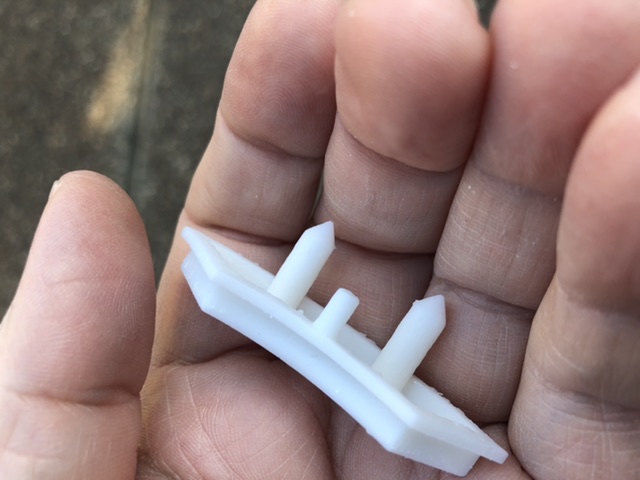

I have seen do difference in density or touch point size as a direct result of the newer peel technology. In fact, I had to use just as much density and touch point as I did on the form 2s. I intentionally decreased touch point and desnity to see how far I could push it and as a result, there were additional print issues due to not having enough support. The print did remove easier from the supports but at a cost of print quality. Now, keep in mind… my printer has mechincal issues and Formlabs is aware of it and replacing the machine as we speak. Maybe the mechincal issues like my X motor travel noise is a main part of the problem.
