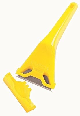

There are tools made for removing paint from glass which I’ve found useful. I found they worked well removing mini rafts that are always difficult to remove. This one uses Stanley Knife blades:
But others use single-sided razor blades.
