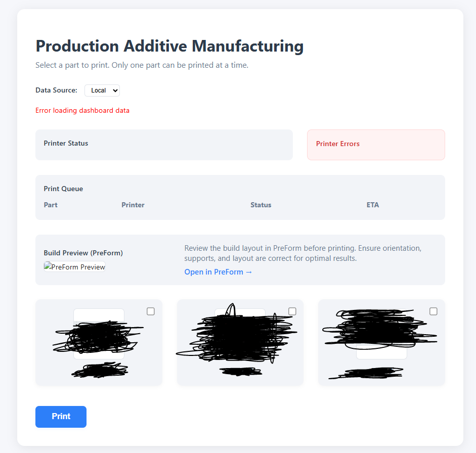

I am currently working on a dashboard for my company that does this exact thing using the labeling REST API for verified print jobs. I am already over 80 hours into coding and have the frontend done just working on the backend and packaging. If there is enough interest I could work on developing a solution to this issue that every Formlabs customer could use. Or Formlabs, I would be happy to work on this project with you to seamlessly integrate in Preform free of charge.
I was not so brave to offer myself to working on this :slight_smile: but I did research and some preparation + some concepts, but in my case it will be just “script based solution” for myself.
@pkonichek Can you show some screens from you frontend?
Here is a picture of the dashboard I am currently working on. I had to scribble out the part geometry and part number. Goal of this dashboard is to simplify our company’s additive manufacturing workflow so that operators just have to select the part number and then press print on an iPad. This process will later be revised as the company production management system will send files to the print group.
