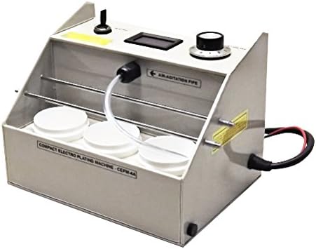

Would this be a viable setup? The variable being getting the conductive primer onto my 3D part.
Can that conductive silver be sprayed?

@Zenica you mention you’ve done plating before - so presumably you have materials already - frankly that kit you linked is a level of sophistication beyond what I was using - which was a materials kit with a bucket, an air bubbler, and a very crude variable resistor and power supply.
I was painting the silver conductive by hand. I’ve never actually used an air brush - but my feeling is no, the silver particles in that paint are very fine, but they still separate from the carrier very quickly. I found that I had to take care refreshing the brush to be sure of an even coat. Also it’s very expensive, so even if it was sprayable, I’m not sure you’d want to.
