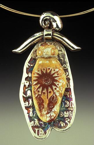

Those are wonderful artists!! That’s big glass, I do jewelry size, been doing glass for 30 years. In my other life, I’m a goldsmith:)) This pix is about 18 yrs old. It’s amazing how our lives intersect and yet we don’t meet. Maybe we will some day:)) I got sidetracked from glass into enameling the last 8 years, teaching at Sawtooth in a couple of weeks. Enameling, that’s baby glass! But with the printer, hahaha I waited for that for 20 years! Kept seeing them demoed at Tuscon, the big ones, and other places goldsmiths and gemologists hang out
anyway as I’m mastering the 3D programs I’m thinking of more uses than just a substitute for wax carving. I LOVE my printer!!
