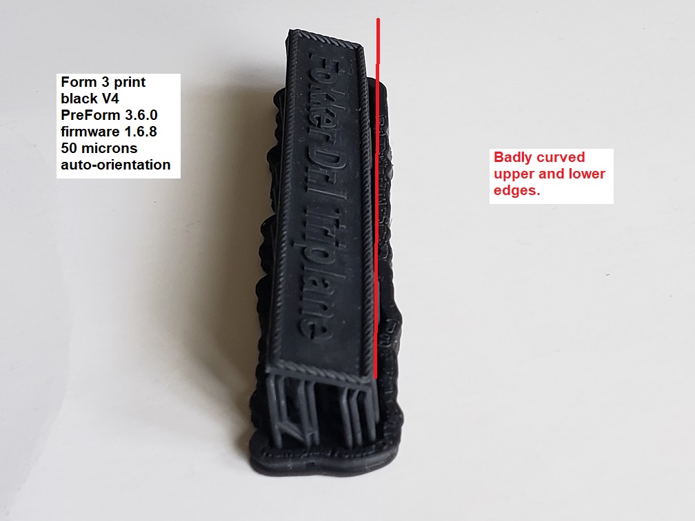

Have been having some success with the Form 3 in gray V4 and black V4 printing models that do not have openings. My Form 3 has achieved a 69% success rate since the 1.6.6 firmware update. This may sound very low but it had a 0% success rate previously. (My two Form 2s have a 96% success rate). So tried printing large, flat objects, to see how the Form 3 would perform, in this case printing nameplates for scale models. As you know, large flat objects are typically challenging for 3D printers to print. My Form 2s print them very well. The nameplates are 10 cm long (~4 inches).

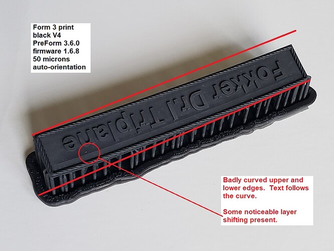

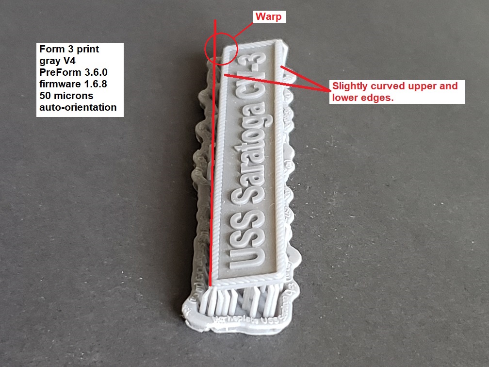

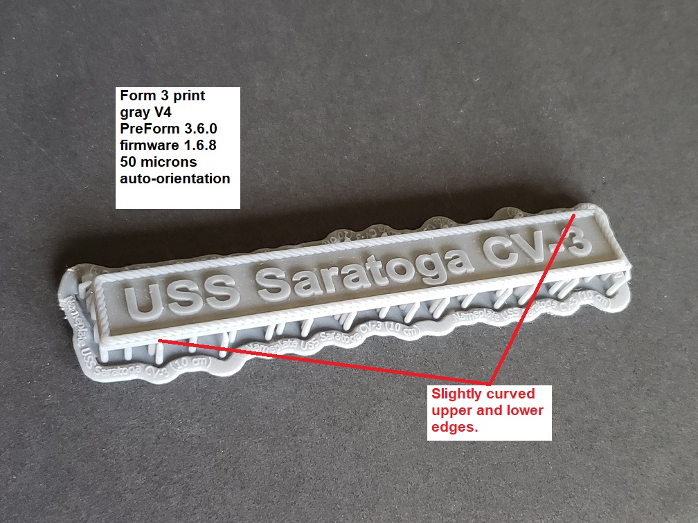

The bad: all test prints were noticeably warped, gray V4 very slightly, but the black V4 especially so. It was if the nameplate were bent in the shape of a frown. Also, the left and right edges were shorter dimensionally than the middle in some cases by as much as 3 mm.
The nameplates were warped such that the top and bottom edges printed curved although designed to be perfectly straight. Text followed the curve. There was some layer shifting present in black V4 but not gray V4.
The nameplates’ top edge, which suffered the most curvature, were oriented down for printing.

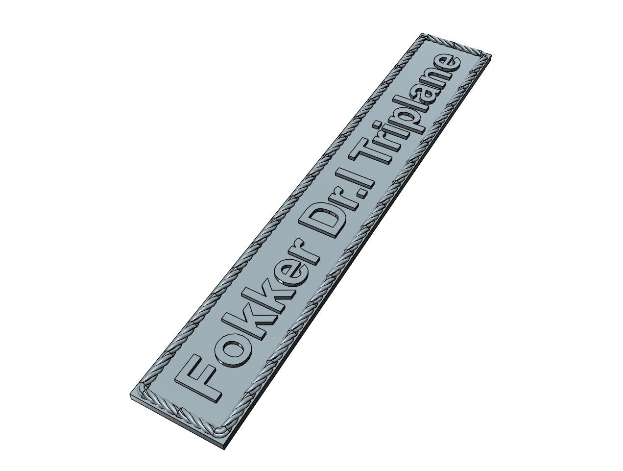

Below is a rendering of one as designed followed by photos of the test prints. Neither gray or black model is sellable in this condition.
  • PreForm 3.6.0
  • firmware 1.6.8
  • 50 microns
  • Gray V4 and Black V4 resins
  • orientation: “one click print” auto-orientation used
Ouch. Does it curve mostly in the Z plane or X/Y?
I know it would introduce other issues but I’d be curious to see what it looks like with the backside printed directly on the base (you’ll probably need to add some thickness).
Did you post cure these, or is this straight out of the wash?
I haven’t seen this problem before. I just printed several mostly flat pieces that were about 11cm, and they were close enough in the X and Y, that they all tile together just fine. There was some bowing in the Z, but shelling out the center helped with that.
What was the support touch point size and density? Supports look pretty sparse.
Also curious how long it was washed for and if this is post cure. I haven’t seen issues like this on my F3.
I don’t think it’s a support issue. That looks like adequate supports for something that thickness. Moreover, at least as far as I can tell from that picture, the supports look straight, and there doesn’t seem to be any warping in them. So it’s not the part sagging against the supports.
Relative to the nameplate, the warp occurs in the XY plane with dimensional inaccuracy at the ends of the nameplate (the ends are shorter than the middle, as if they ends have shrunk in the XY plane). The nameplates are uniformly thick in the Z plane, as intended.
The flat background portion of the nameplate is 1 mm thick. The rope border rises another 1 mm above the background for a total thickness of 2.0 mm. The text rises 0.75 mm above the flat background.
9 nameplates tested. All nine warped. Warp in black V4 much worse than in gray V4.
Yes, the supports are straight. I may be wrong, but the print raft does not appear to be warped, just the nameplates. No sag between supports. Once removed from the raft, the back of the nameplates are flat, as intended.
Touchpoint size 0.6 mm
Touchpoint density 1.0
Supports and orientation auto-generated by PreForm for 6 of the nine test prints. The last 3 nameplates were auto-generated in PreFrom then their orientation was manually changed to increase the angle of the nameplate relative to the build platform, and to increase the number of supports, and for test print number 9 to change the nameplate orientation on the build platform in the Z plane by 90 degrees. Manual changes did not improve the warp or eliminate it.
Warp noticeable before wash and cure, right out of the Form 3. FormWash and FormCure had no noticeable affect on the existing warp. In other words, the FormWash and FormCure did not create the warp nor worsen it.
