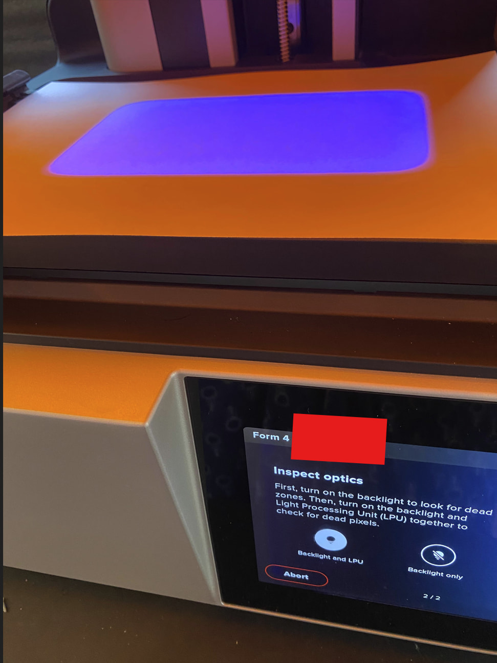

We have now run Inspect Optics, and I am attaching the resulting images.

@Ashwini You do have a malfunctioning LPU. Please open a support case so that we can help get this resolved for you.
