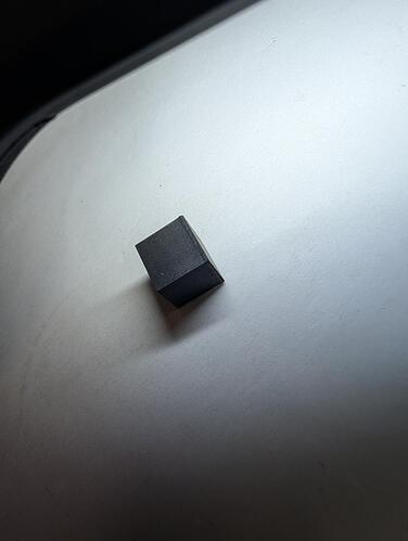

Hi everyone,
has anyone here worked with ESD resin on the Form 4?
What are the best settings to minimize the elephant foot effect?
And how small can I make the support structures while keeping them stable?
I’ve attached my current settings and a picture showing how it looks now.
Hi @KuemmeMl ,
Sorry to see you’re having issues. We have a support article to help you with this phenomenon, see here. There’s a section Removing build platform flashing from parts printed in ESD Resin on a Form 4 which could be the most useful for you!
If you’re still having issues after revising these troubleshooting steps, please open a support case on our website.
